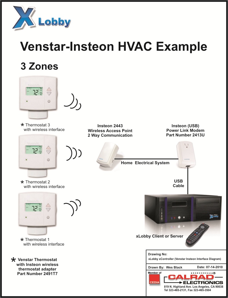

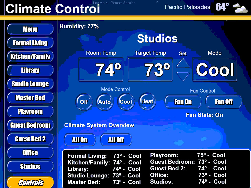

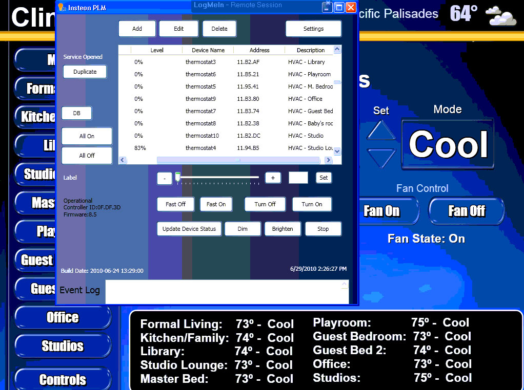

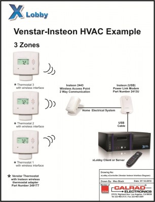

xLobby controlling 10 Separate Zones of HVAC using Insteon TechnologyxLobby xController setup using the Insteon ServiceThe device name "thermostat" must appear first in order for the service to communicate with the Insteon PLM properly.

Venstar 7 day programmable thermostat with Insteon 2441v Wireless Thermostat Adapter attached
