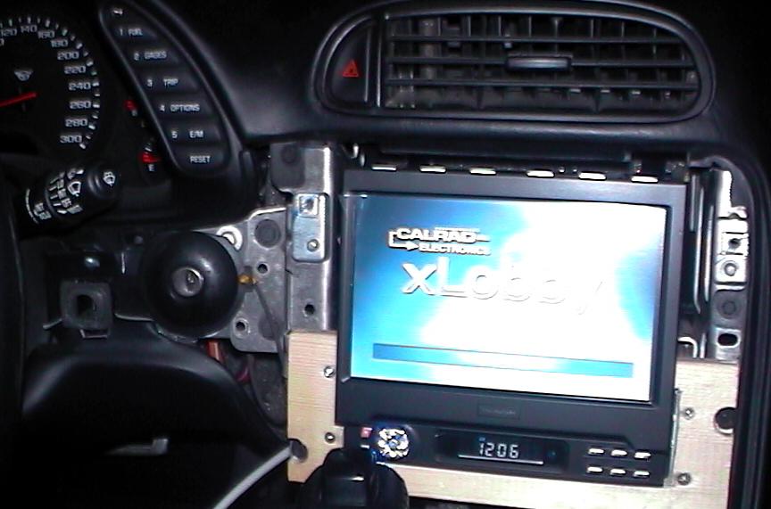

I have few years experience in carputing (been using tablet), but this is first time im building dedicated carputer so im excited. Im very familiar with comps, but cars are not my strong point so im expecting some troubles getting touchscreen installed, heres where it should go, P3rvette dash:
As u can see Corvette (atleast c5) totally sucks when it comes to DIN space or OEM headunit

I been taking some measures, removing OEM headunit, leaves me with 2 DIN space, enough for In-dash motorized 7" touchscreen and After market HU. That sounds simple enough installation, and im thinking in favor of this aproach.
But i wanna hear what u guys have to say, cause ofcourse staticly mounted on-dash touchscreen would be way cooler and neater than In-Dash, so if i would remove smoking unit (ive been nonsmoker for over a year anyway) and replace it with heating/cooling unit i could just barely fit 7" screen and one DIN HU above it. Any bigger touchscreen is unfortunately no fit if i need space for HU too...
Any ideas or thoughts on this guys?
Also im bit puzzled how do i connect after market HU to the Bose system. I think atleast some of the speakers are active
