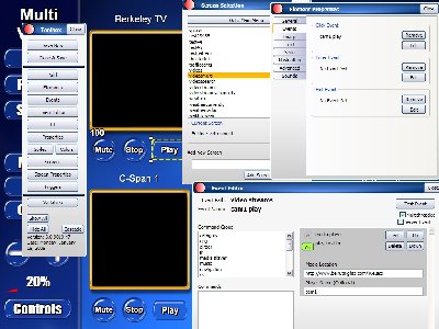

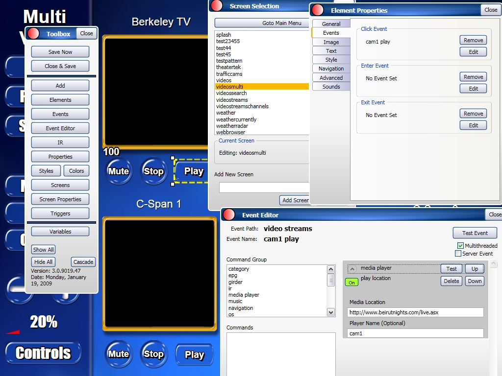

Bill, the current audio player has a difficult time playing ASX file types, here is a temporary solution. You can play this file from the videosmulti menu using the internal media player. You can add a player to your IP radio menu and use the "button set text" command to display the station title. Most likely we are going to build the windows media player dll into xlobby so we can select between our internal player and exploit WMP inside xlobby. The only drawback is some minor issues that will effect multizone audio from the first zone using the internal sound card, additional zones have to use the internal player. But in any case this will allow us to use visualizations, equalizer, crossfading etc. from inside xLobby. Using WMP will also allow us to playback a wider range of file types.
See this screenshot:
