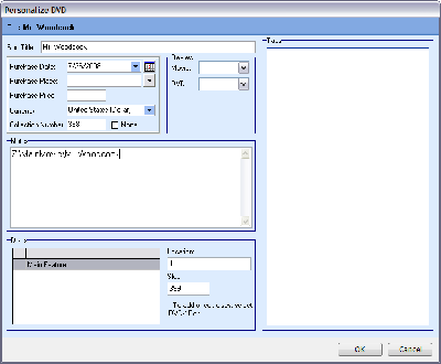

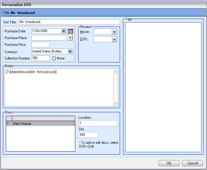

I've dealt with this one before. When I changed from my Sony DVD Megachanger I had to make sure that somehow I had DVDpro pointing to my online title. What I did at the time was create the files path in the notes section in DVDpro that use that as my parameter for xL to play from. It worked!!

Postby carlt7 on Sat Jan 31, 2009 2:56 am
Sharp and Marbles - Thanks for your reply. The Profiler setting won't apply because (I was not clear) there are 200 movies on a 1TB hard drive that need a correct movie path in XL (after importing CC Viewer database.) The path found when editing the database shows "video_ts" and not, ie, M:\shooter\video_ts\video_ts.ifo. I tried Ant (with no success) but the instructions I found in the forum were a little lacking. I wish the post/instructions in French with visuals would have been translated into English. I will go back and try Ant again. I assume it will work in 2009 with XL Free, right? Thanks again for your help.
