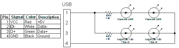

I ended up constructing my own IR bar that plugs into the USB port. I tried using 2 high output IR LED's. They drop 1.2V each, draw 50mA, and have a 950nm wavelength. Hooked them up in series along with a current limit resistor of around 49.9 ohms. Unfortunately, first test reveal that it is only good for about 3 feet, using the wiimote software. Oh well, back to the drawing board.

Added another two IR Emitters and got the range to around 6 to 7 feet. That should be good for where I'm sitting. Two per side with about 11" of space in between. I noticed in the wiisoftware that at that distance, they were sensed pretty close together, so I might expand that space somewhat. If anyone is interested the basic circuit is shown below. It draws just under 100mA, which is the limit of the USB driver. Total cost around $10. Most of the expense went to the USB cable. Probably could have found it cheaper, but I just picked it up at the local electronics store since I was already there for other reasons. The Panny emitters I already had. The KL emitters I picked up at the same time as the USB cable for $1 each. The 49.9 Vishay's resistors I had available at work.
