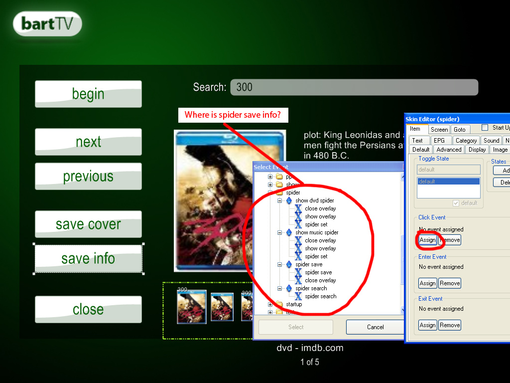

Apparently there are two spider save events. I'm not sure how to access it, because it is not in my events tree, but the two are:
Xlobby:spider save (to save the selected cover)
and
Xlobby:spider save info (to save information spider save info)
(according tocorwanrq viewtopic.php?f=7&t=3640&start=30)
I dont have it, and I dont know where to create it, or how to even create it.
Have a look at the screenshot below.
As you can see, there is no Spider save info event.

To get the information to save to my XML file from the spider screen, I had to go and create a new event. Took me awhile, as I had no knowledge of how to do so, but here's what I did, so you can do the same.
1. Open XL.
2. Hit F2, then click "Events" from the left column menu.
3. What I did at this point, was created a new root-level group first, and named it custom for remebering I did it at a later date. So, you need to click the "Add Group" button near the bottom of the middle pane, then name is something appropriate.
4. Now, create and event inside of that group, by clicking the "Add Event" button, while you have your folder you made in step 3 selected. I named mine logically, "Spider Save Info Custom".
5. With your new event still selected, bring you eyes over to the right pane. You should see two tabs. Select the "Commands" tab. In my experience, I needed the Spider Save Info event, so I browsed down the tree menu to this path: xlobby>>spider save info
6. Now simply click the "Add" button, in the bottom right of the right pane, and you will notice that is has now added itself as a "component?" to the event you created. If it didn't make sure you had everythign selected that I instructed you to. Retrace your steps.
7. Now all you do is assign this new event to a button on your spider screen. NOTE: This does not save the cover art, only the text data.
