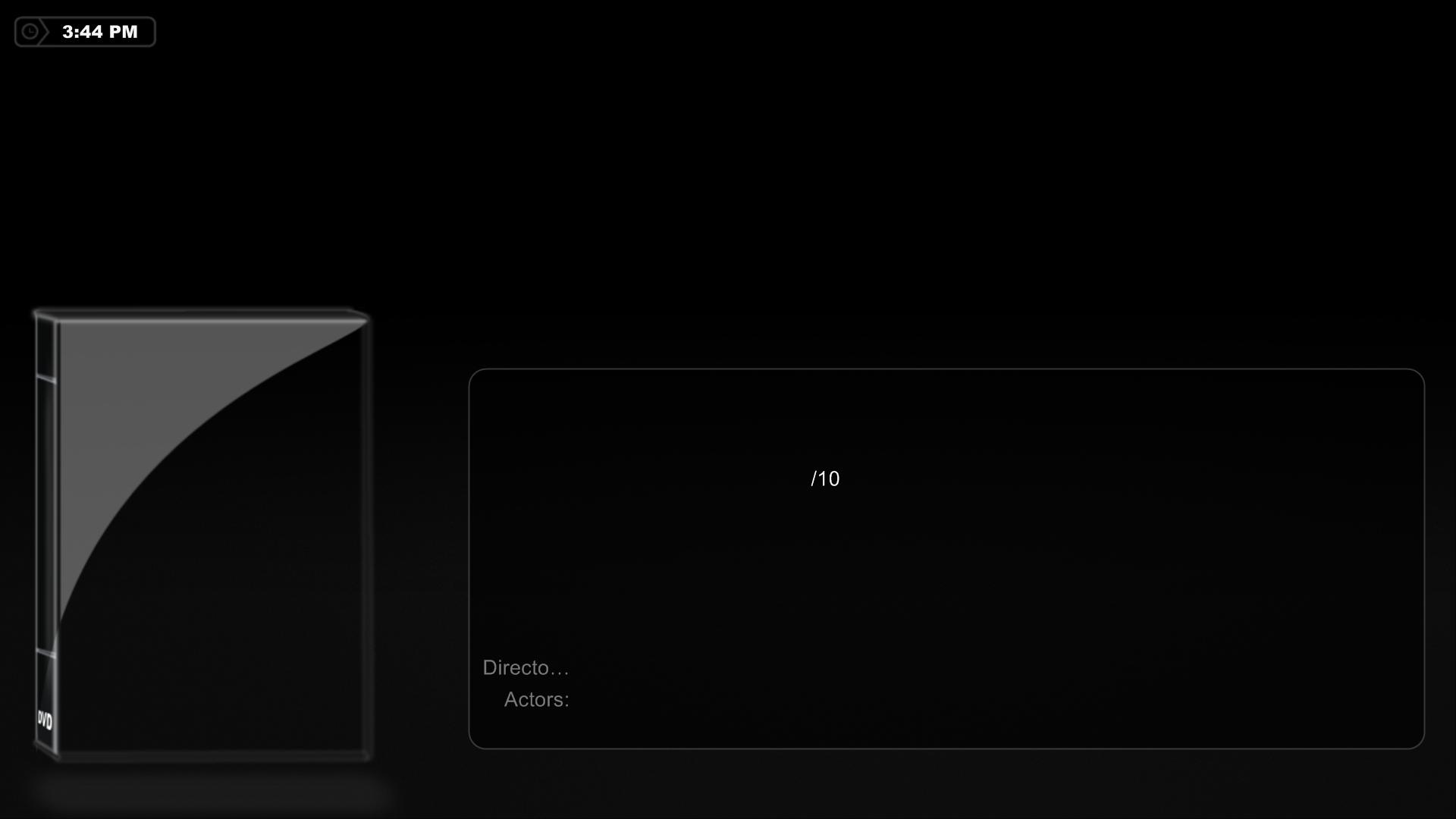

I gave this a quick look last night...I did have a couple issues, one of which I think you talk about the post above. From the movies screen the buttons did nothing. I did go in to the startup event and check that is was set properly and test it...after that they were working.
The next problem is after you select a movie and it takes you to the movie info screen nothing displayed on that page...even the items that were set up properly and showed on the other pages. Finally from that page if I hit enter it pops open the full screen movie page but nothing plays. I was not able to spend much time on it last night but those were the first couple things I noticed.
Could you attach a screen capture of your movie listing screens (movies_list, movies_large, movies_small, or movies_coverflow screen) and then attach a screen capture of your movie info screen. I can't think of why things would show up in the one screen but not the other. They are all using the same database and tag information (example: catalog>movies>coverart).

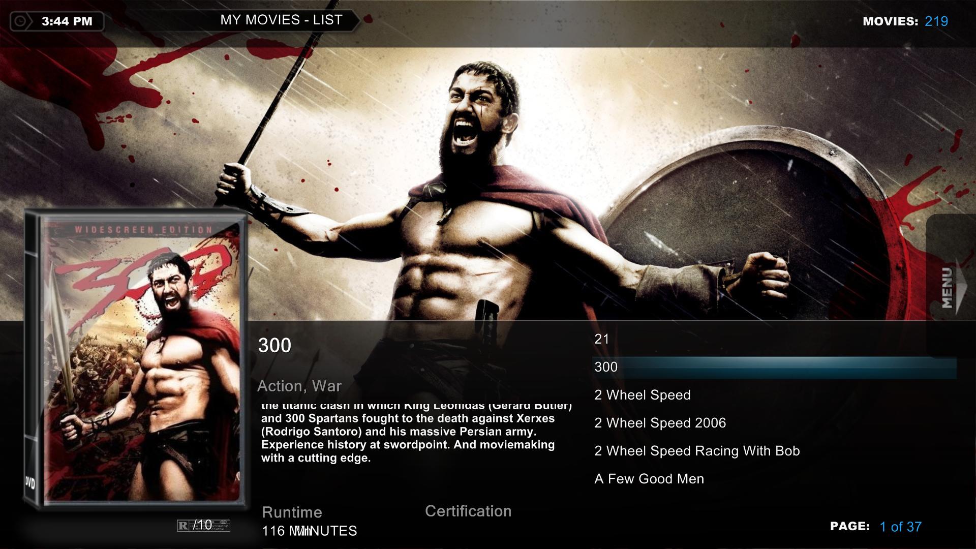

Here are my screens for Movie List and Movie Info.

As for your movie listings and info, I'm wondering if the fields your using and moviestemplate is different. I say this because in the movie listings screen, down in the rating area, it shows the graphic of the movie certification, and not the rating. In that screen, it shouldn't show any certification graphic but under "Certification" it should state in text whether the movie is "G", "PG", "PG-13", "R", or any other ones you may have added.

Yeah, I have the movie 300 too, and looking at the movies listing screen, and comparing, I noticed that you either are not filling in the ANT parameters, or not filling them in correctly, or are using the parameters differently. I say this because if you filled out the parameters as I indicate in my help doc, then across the top, should be the following images (depending on what fields you fill in ANT):
Media Type (DVD, BLURAY), Audio, Resolution, Video Codec, Subtitles.
I can tell that you do have the image files in their proper location because of the "Restricted" image down by the rating spot. This indicates though that you are filling in the fields differently than how I have done it. Nothing wrong with how you are doing it, it just means that you will have to modify the moviestemplate.xml file to suit.

I definitely don't have all the movies database stuff set up like yours so I am expecting some of it to be missing or out of line. The things I was seeing on the other screens I ignored for that reason. The movies info screen though was a whole different story since it should have at least displayed the things I did have tagged properly. I now can see the cover, fanart, move name and plot....anything else tagged properly on the movie info screen but what I had to do in order for that to work was add a category to that screen named movies and point it to the movies database. I then set it to hidden. Now everything shows up. I had to do the same thing to the pause movie screen.

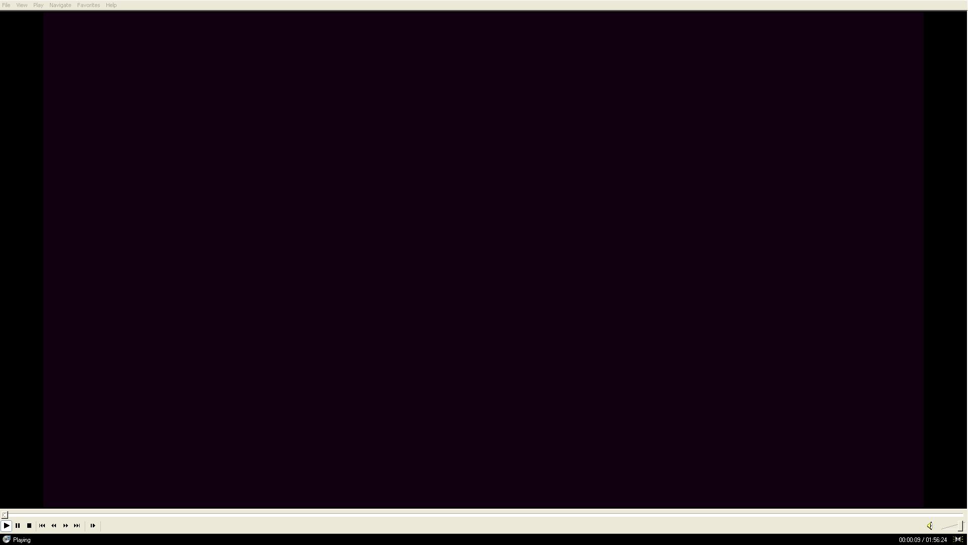

As for getting a movie to play from that screen I had to create a new play event. This one goes Execute (Movies) , go to screen (movies_fullscreen), wait, execute file (sendfocus to xlobby). The movies launches and plays this way, for whatever reason even when set it up this way and have it go to just fullscreen it still doesn't play on that screen. When focus is sent back to xlobby the mpc hc screen shows the border around it with all the menu options like this.
Is there a way for xlobby to have focus and this not show. We control things differently though so the way my set up works now is where I would want MPC to have focus, unless I change it up and control everything the same way you do. Maybe some of the issues I am facing have to do with not using the remote.
That is very strange indeed. Not too sure why you would have to create a hidden category to display that stuff. I'll be mulling that one over for a while. I haven't done anything different from what I and others have done when calling on tags from a category/database.
If you want to take out the menu and scan displays from the MPC window, and only display the movie screen, just uncheck those options from the MPC/View dropdown. Close MPC and re-open, they should be gone (that's what I had to do if I recall). My only problem with MPC right now is that when not using fullscreen (which you don't have to with xMoveWindow), the mouse shows up, even if I use xHideMouse. Doesn't show when using Zoom...only with MPC.

If you are having trouble launching in fullscreen then in MPC-HC's options page set "launch files in fullscreen" on the playback>fullscreen tab.
On older versions it is on the player tab (very top of list).
To get rid of the borders when in windowed mode, just press "1" and it will remove them completely. The option change is persistent, even if the player is closed, until you change it back by hitting "2" or "3" (3 has the full borders you are showing).
@Marbles
It is showing the mouse cursor because it is actually reverting to a window on the obscured desktop. You would have to hid it within windows itself. The easy solution is to use a mouse to pull the cursor to the far edge of the screen where it will disappear from view, but that would have to be done each time the computer is started. If it is a dedicated HTPC you could always create a blank cursor and set it through control panel>mouse (win 7 path). I don't know of any way to outright disable the mouse cursor since Windows expects that you will have one to actually use the OS in most cases.
