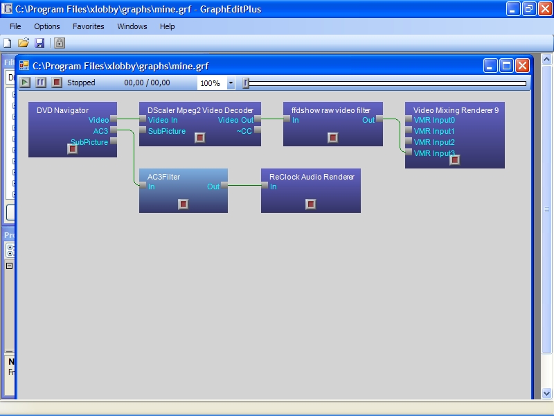

Now do you know anything about the problems in passing AC3/DTS as passthrough in spdif i'm having. Below is what AC3 filter is saying, it keeps disabling passthrough????
"Input format: MPEG Program Stream - 48000
User format: PCM Float - 0
Output format: PCM Float 3/2.1 (5.1) 48000
Use SPDIF
SPDIF status: Disabled (AC3 encoder disabled)
SPDIF passthrough for: MPA AC3 DTS
Do not use AC3 encoder
Check SPDIF sample rate (allow: 48kHz 44.1kHz)
Query for SPDIF output support
Decoding chain:
(MPEG Program Stream - 48000) -> Demux -> (AC3 - 48000) -> Decoder -> (Linear PCM 3/2.1 (5.1) 48000) -> Processor -> (PCM Float 3/2.1 (5.1) 48000) -> Dejitter -> (PCM Float 3/2.1 (5.1) 48000)
Filters info (in order of processing):
Demux:
Decoder:
Stream format: AC3 3/2.1 (5.1) 48000Hz
Bitstream type: byte stream
Frame size: 1792
Samples: 1536
Bitrate: 448kbps
SPDIF stream type: 0x1
Frame interval: 1792
Actual bitrate: 448kbps
AC3
speakers: 3/2.1 (5.1)
sample rate: 48000Hz
bitrate: 448kbps
stream: 8 bit
frame size: 1792 bytes
nsamples: 1536
bsid: 8
clev: -3.0dB (0.7071)
slev: -3.0dB (0.7071)
dialnorm: -27dB
bandwidth: 14kHz/20kHz
Processor:
(Linear PCM 3/2.1 (5.1) 48000) -> Input levels -> (Linear PCM 3/2.1 (5.1) 48000) -> Mixer -> (Linear PCM 3/2.1 (5.1) 48000) -> Bass redirection -> (Linear PCM 3/2.1 (5.1) 48000) -> AGC -> (Linear PCM 3/2.1 (5.1) 48000) -> Delay -> (Linear PCM 3/2.1 (5.1) 48000) -> Output levels -> (Linear PCM 3/2.1 (5.1) 48000) -> Linear->PCM converter -> (PCM Float 3/2.1 (5.1) 48000)
Dejitter:

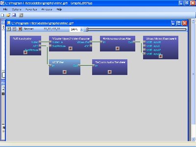

This is using a default direct sound device in graphedit. I want to use Reclock, which in AC3 says spdif passthrough ok but i get no sound. In zoomplayer when i select AC3 and reclock as the audio renderer it works fine. This has me stumped. I want my nice Arcam AV8 processor to be doing the work.
Thanks anybody for the help
