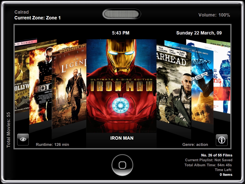

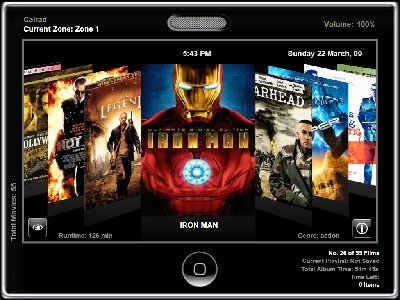

Postby Grooby on Sun Mar 22, 2009 8:35 pm
Sean or anyone else...can you post a screenie of the script or a script done to download to reproduce the below (and any stages to get working so a simpleton can follow :oops: ...)
I am trying to reproduce for my cover flow but with no luck...
Much appreciated if you can
Re: xDatabase
Postby S Pittaway on Wed Mar 25, 2009 5:31 pm
i am on holiday at the so i cant really help.
there isent a script as such, its controlled thu the ini file.
on the 1st page, look at "Routines for caching database coverart" and "Database Image Cache" and the ini file dump.
If that doesent work, you can page up to where rusty was trying to get it to work, if you have a play with his ini file and my suggestions it will get you going....
remember to backup your database before playing with it.
