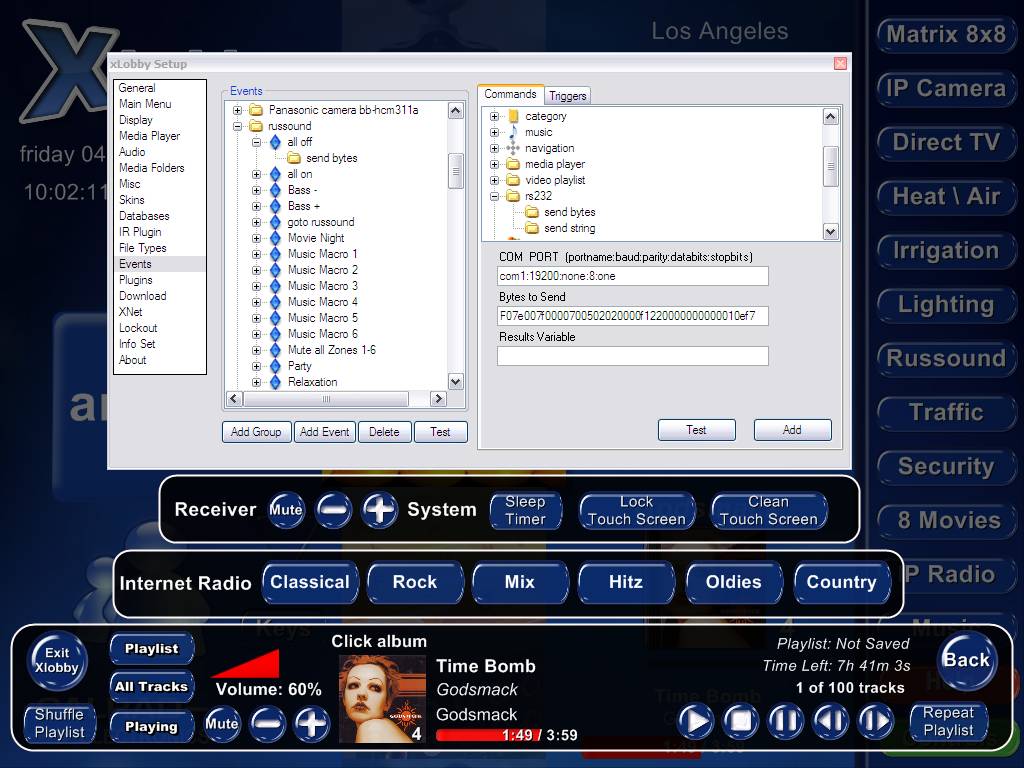

Has anyone set up a russound zone system? Do I need to install anything for the RS232 to work? I have steve's default screens but don't really know where to start. Can anyone point me to some documentation? Thanks

So to answer escorts post, you must have a Rs232 serial port on your xLobby machine, next connect a serial cable between your xLobby machines serial port and the Russound controller, this will establish communication between the 2 units. If you goto the russound example events under F2 you should be able to start sending any of the commands instantly. If communication is not possible, turn the Russound controller off and wait 30 seconds and then turn the power back on.
The example serial port communication settings are preset to Russounds RS232 values and should not be changed.
