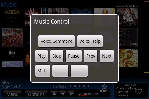

We moved the voice command stuff out of settings into the interface, you access it by tapping and holding down for about 1sec, that will give you a popup of some new options...should look like the image below.
A bunch of voice commands have now been added, check out voice help for the whole list.
The transport controls also work.
Next things we plan to add soon is the ability to save multiple xlobby servers, movie controls, navigation controls, and custom voice triggers. One thing at a time though.
I think you'll like the voice recognition stuff, it's so easy to say "play artist weezer" or "play category rock" instead of finding it. You'll see.
