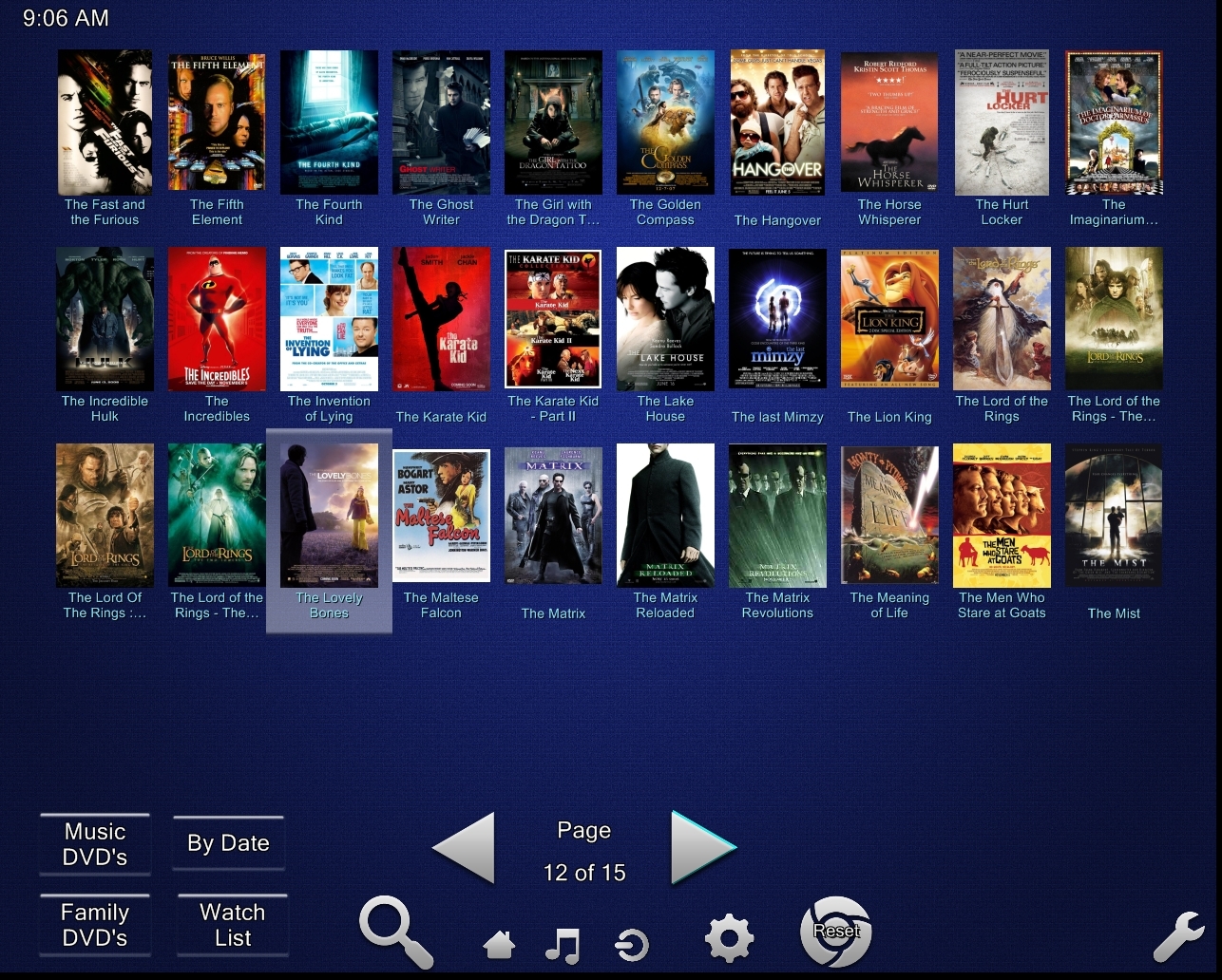

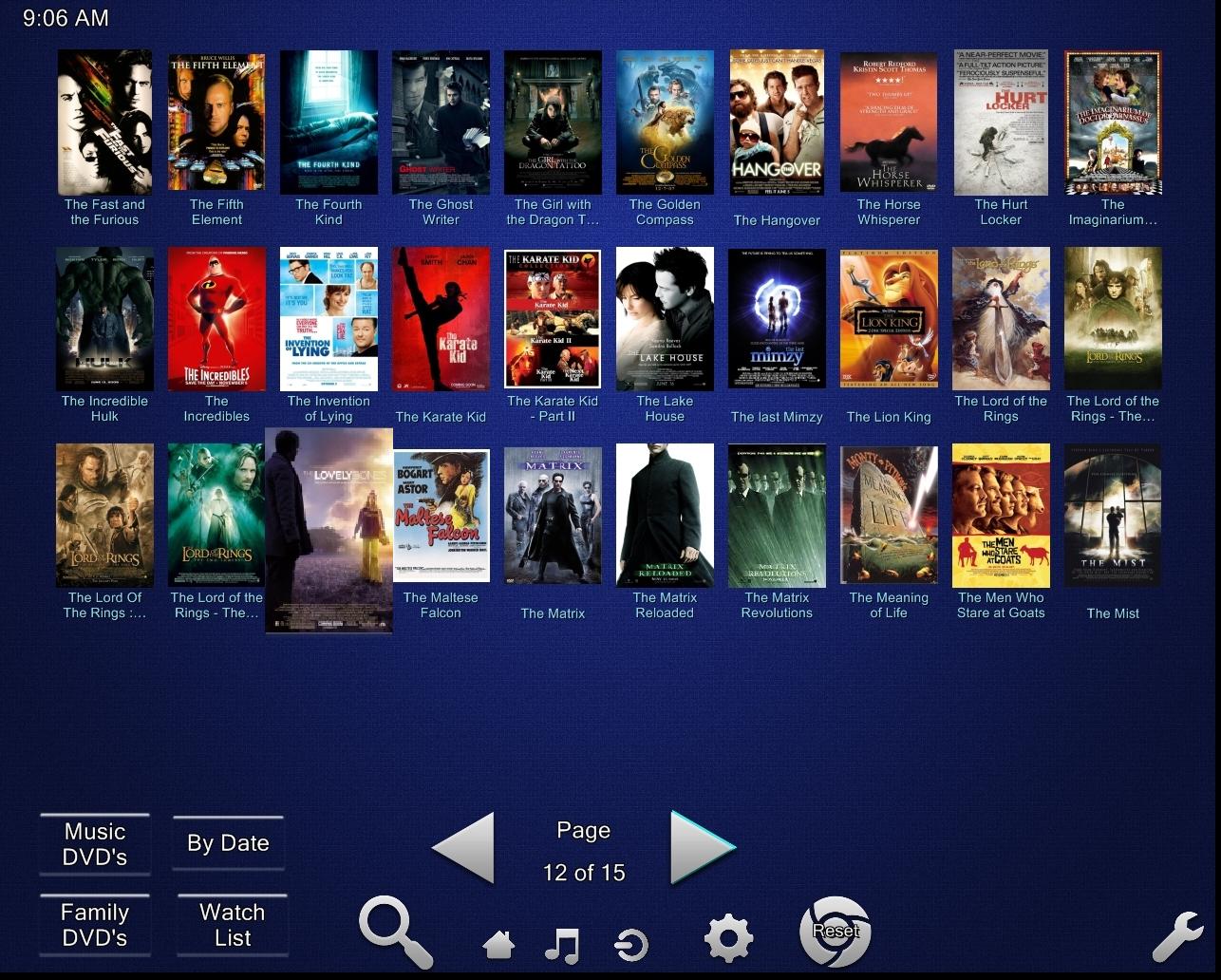

I would like to change the 'selected movie' image in the movie category.
Is it possible that instead of displaying a button to actually display the movie cover art .. only it would be a little bigger when you mouse hover. I think that would have a good look.
So it would look like this...

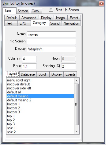

Did you toy around with the Category/General settings (if using freelobby, Pause/Break, then Category tab, General). Try and play with the Enlarge % and the Highlight %. You could also play with the settings under the Layout tab, but they will affect all of the items in the category, not just the mouse-over one.
Another way is to center your actual movie category. Make the size of it to only show one cover (enlarge it, make the highlight bigger etc.). Set the Layout to default all (I think that turns off the title and only shows the movie art). Then use text boxes all around the centered category. Text boxes to the right of, and below the artwork will be this:

Postby Marbles_00 on Thu Dec 02, 2010 2:22 pm
To give you an example of what I mentioned above:
The second coverart from the left (Blades of Glory) is the actual category. The "Blackhawk Down" image is a text box that contains the following:
Code: Select all
category>movies>cover>-1
"Body Of Lies" image is a text box that contains:
Code: Select all
category>movies>cover>+1
"Bolt" image is a text box that contains the text:
Code: Select all
category>movies>cover>+2
