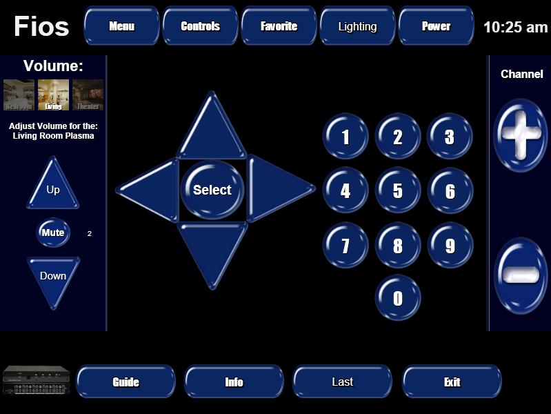

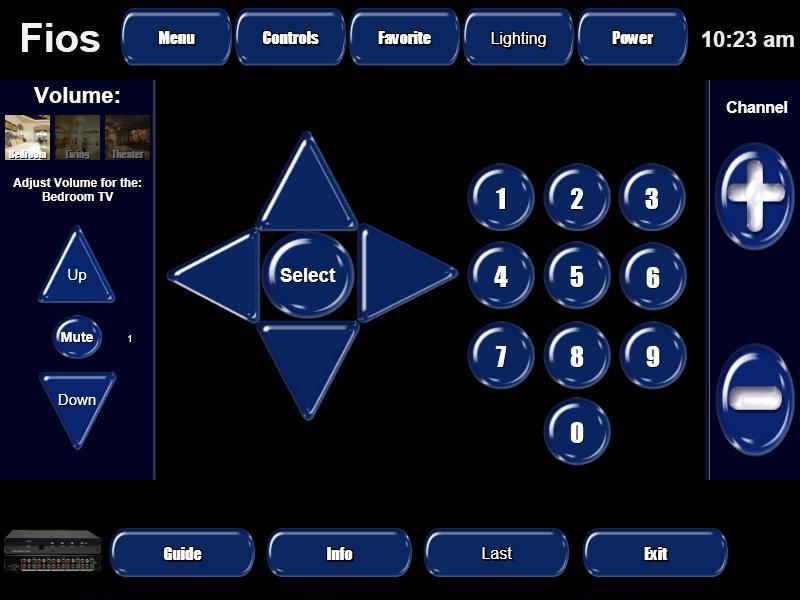

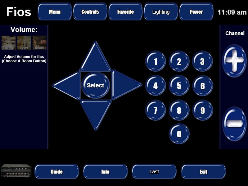

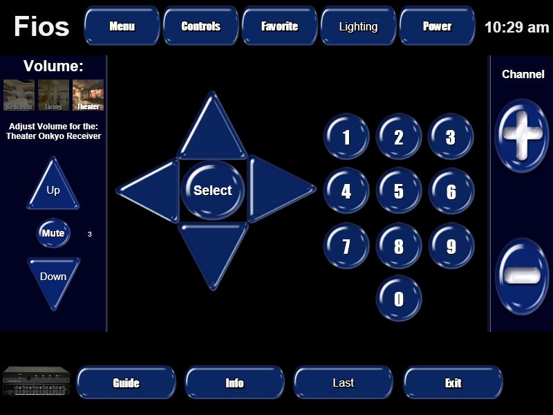

Here's what I came up with using the "default" buttons - I would have posted this last night (ahem, very early this morning), but I was typing so furiously, that Dafna, came into the office to let me know I kept waking her up. Maybe I was angry with my keyboard for letting me create a whole series of screens with overlays and jumps back and forth, only to find that the events I requested in Mantis already exist :embarrassed:
(The "view more smilies" link on the forum appears to still be broken :shock: )
[edit]
Multiple Volume Controls.zip
(611.65 KiB) Downloaded 269 times
[/edit]
These are some of the command pairs that can be used to accomplish multiple buttons in one spot using "ButtonIDs":
xlobby>button colapse
xlobby>button expand
xlobby>button hide
xlobby>button show
xlobby>button disable
xlobby>button enable
If you play with these it should become clear how they work.

that is exactly how i wanted it, one control, with 3 options to choose which TV you are changing.
i will play with those events tonight.
