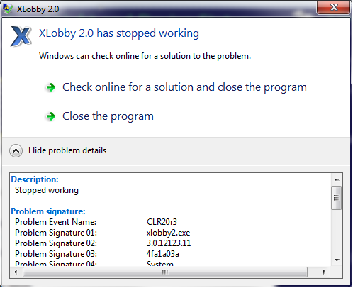

Xlobby is crashing on startup fairly regularly lately for me. X completes all of the regular startup steps, and after the "Starting Xlobby.." step, it switches to my main screen but then throws this error:
Is this a problem with my system, or is it something specific to xlobby? I've added a couple of buttons to my main screen in the past week, but nothing weird or new?
Thanks for any thoughts on how to troubleshoot this!
[edit - this was caused by the xoap-weather plugin. I was not actively using xoap-weather, but had accidentally left it in the xlobby/plugins folder. removing the xoap-weather directory appears to have solved this problem.]

Update: I checked the xlobby log and saw that my menu screen had a "enter event' associated with it - the xlobby action calls a girder event to get the current sunrise and sunset.
I recalled having problems before when I tried putting "enter events" on the main menu screen, usually resulting in xlobby crashing, so I"ve removed this "enter event" for now. Xlobby seems to be starting ok again now and will keep testing.

Unfortunately, this xlobby crash and error code still occurs, just not as consistently. It happened again overnight - I woke up and X was displaying this "stopped working" window again.

Check your xlobby folder for a file called "log-crashes-xlobby.txt", upload that if the times look right at the top it will help me track it down. I tried creating an enter event but I couldn't get it to crash, it's possible it is the enter event and you are trying to do something too early. Hopefully the log-crashes file is there.

Thanks for the tip on the log-xlobby-crashes.txt file. That helped a ton! Here's the crash-log. It definitely coincides with the Stop error, and it was related to xoap-weather, which I no longer use and I thought I had uninstalled! I no longer use this plugin so I've deleted it. Hopefully that resolves things. I'll test for awhile and update the subject to [resolved] if so.
