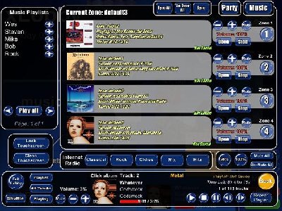

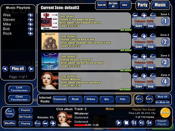

xLobby with Multi-Zone with 4 Seperate zones, Audio Dongles or Internal Audio Amplifier Cards
http://xlobby.com/images/screenshots2/Music%20Multi%20Zone.jpg
[url]httpxLobby with Multi-Zone with 4 Seperate zones synced, Audio Dongles or Internal Audio Amplifier http://xlobby.com/images/screenshots2/ ... ynched.jpg[/url]

Multi-Zone updated features. Remember this overlay is used to demonstrate the power of xLobbys capabilities and can be stripped down for each users own needs. The old simple overlay (overlaymusiccontrols2.xml) is still part of the skin and can be used if needed.
1. Added master Un-sync event to un-sync all zones that are allready synced up.
2. Party Button to automatically start playing random music in different zones.

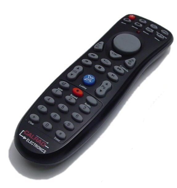

3. Use Calrad remote to select zones to be controlled and change tracks, play pause, etc. Select the numeric digit 1-4 to control each zone.
4. Stop button for each zone.
5. Quick playlist access and control.
6. Mute or un-mute all zones plus audio level presets.
7. Added one more IP radio station.
