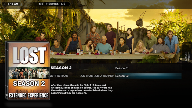

Currently working on two modules. One is the TV Series Module. I've finally learned how to use the xTVdB plugin, and putting it to good use. The other is the Video Module that will playback video clips of home videos, or adult videos etc. It will also playback offline movies that may reside in the DVD Rom drive. Below are some teaser pics. Stay tuned for their releases.
TV Series Main Menu (sorry, I only have seasons of Lost, but this will be the starting point to select your series to watch)
From the above screen will take you to the Season screen to select your series season. There are four views that will be selectable, like the movies - list, large icons, small icons, and coverflow.
List View
Large Icon View

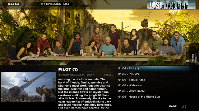

Once the season is selected, you will be presented with the Episodes screen to select the episode to watch. Again you can select the four views to present the episodes.

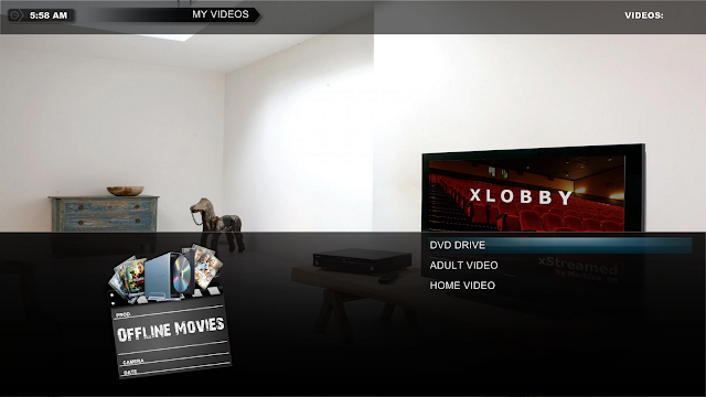

And here is the main screen for the Video Module:
I've also updated some of the "TV" backgrounds to be more personable towards xStreamed (as shown in the Video module background above). GIMP is so much fun...especially the "perspective" tool. :D
