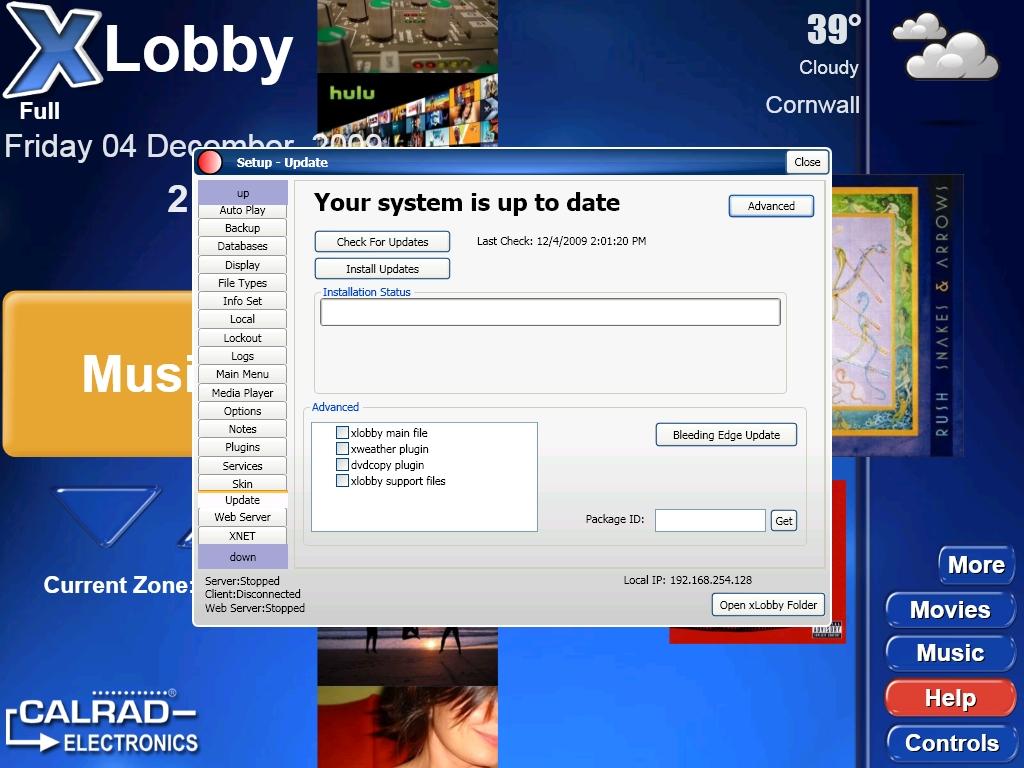

Postby wesblack on Fri Dec 11, 2009 6:14 am
Your crash issues were a bug that we finally found and fixed. In the future use xLobbys new builtin update system, under the setup menu select the update tab. You can install standard xLobby releases and plug-in releases. You can also install beta bleeding edge xLobby updates that can sometimes solve issues between major xLobby releases. Pressing the (Check For Updates) button will check to see If your system needs upated, if so then xLobby will list the updates, (user selectable) otherwise it will indicate that your system is up to date.
