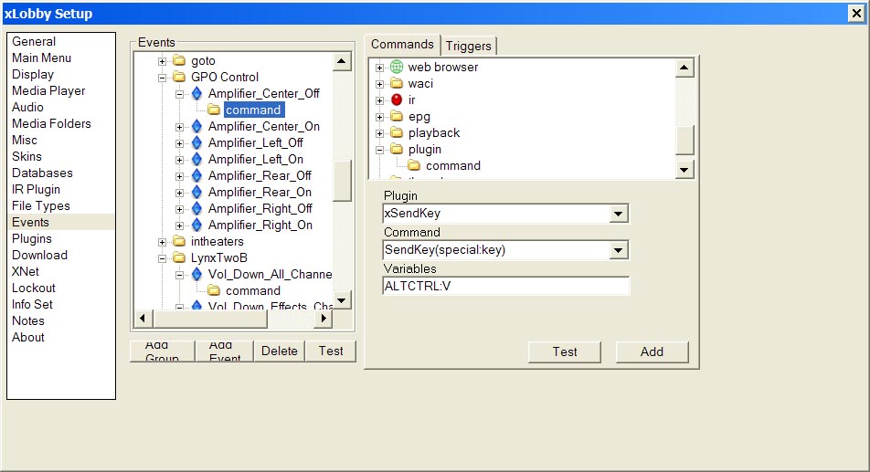

Anyone know the command to send multiple keystrokes with xSendkeys. The normal command would be KEY:F2 but how would I send ALT CTRL 2??

Here is what worked for me: ALTCTRL:V
If you have problems let me know I found a bug in the plugin that did not allow certian combos to work. It was awhile ago when I identified the problem so I do not recall the specifics.

Here is a little more for you:
Key combos: (you use what is in the "" --- example SHIFT:LBUTTON)
