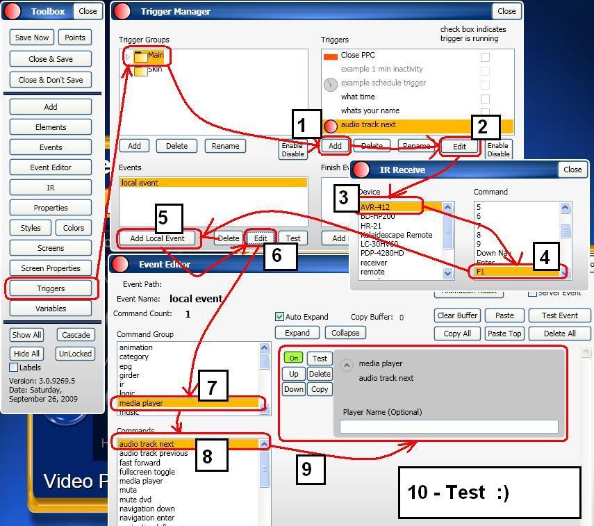

Is it possible to switch subs or lang when video is playing in fullscreen from remote, or does one have to exit fullscreen and then press the buttons on the screen?

You can create a trigger that when activated, calls the event under the sub or lang buttons.
here's an example of how to add one event:
(*Disclaimer: I am not at a machine where I can test this method, but it "should" work.)
To add an IR trigger for "audio track next":
select Triggers from the Toolbox in Editor, then choose wether to add the trigger to Main or to Skin - I chose Main - under the Triggers box click "Add" (1) and then to select an "IR Receive Trigger" click the corresponding "add" button in the popup box (not shown in my messy example screenshot). Enter a name for your new IR Receive trigger and click "Ok" to close the popup windows (also not shown).
Next, click the "Edit" (2) button under the Triggers box to open the IR Receive window where you will select the corresponding IR device (3) , and then click the IR command (4) that you want to assign the trigger to / the IR command you want to assign to the trigger. - Nothing else to click here - the highlighted IR command is all that's needed to make the new trigger activate every time the highlighted IR command is received by XLobby. - you can now close the IR Receive window, or leave it open for reference - it doesn't matter.
Next you have to add the event that will occur when XLobby "sees" the IR Command tied to the new trigger. Just clisk the "Add Local Event" (5) button under the Events box. "Local Event" in this case indicates that the event will be executed when the trigger is activated - it is not the same as a "local screen event". Now click the "Edit" button under the Events box (6), and the familiar event editor will open where you will select "media player" from the Command Group, and then drag "audio track next" from the Commands Box (8) over to the Event List Area (9).
The steps are pretty-much the same for adding any other type of trigger.
I know, it's much more detailed than you probably needed, given your experience, but hopefully others will find the step by step explanation helpful.
Messy pic, but the info is there.
